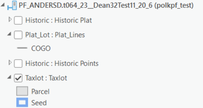

As a follow up.  When I use the ChangeVersion tool in the python script as follows, all of the feature classes that participate in the record change.  Unfortunately, the "TaxlotsPF: Records" feature class does not and remains in the old version.

The results are.... All feature classes Except Records are transferred to the new eversion (also no error message).

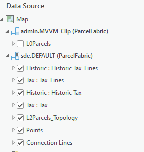

This is my map after targeting only the parcel fabric:

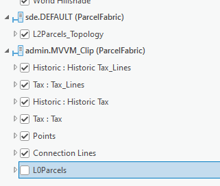

UPDATE:
I ran the script from the Python window and the parcel fabric and parcel layers all change version. The topology does not:
