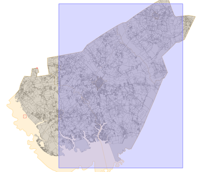

I spoke with a tech rep and ended up with 4 concerns.
Build Extent over several small parcels creates a very large and displaced dirty area. The extent built is not "dirty", however a different area of the map is. The area I built is the small red rectangle in the SW area of the screenshot, but the dirty area is nowhere near that area.
  • This only occurred when working in an area encompassed by administrative parcels. If I created a new tax parcel far outside the boundaries, build extent worked as expected and the dirty area only encompassed the area built.

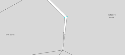

When selecting a point that is shared with an administrative boundary, Merge Points locks up UI for minutes at a time and nothing else can be accomplished.
  • This also occurs with very large standard non-admin parcel types. For instance, I have a large lake in my county that has a Zoning polygon. If I select a point that is used by this large polygon, Merge Points locks up.

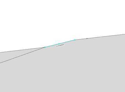

Using Copy Parcels to export my fabric for upload to technical service, I had one small issue in the output fabric where two parcel vertices were merged and the lines were not. I only discovered this when validating the fabric and an error occurred be because the lines no longer coincided with the polygons. The vertices were within the horizontal tolerances so Clustering shouldn't have affected this. This isn't related to my original posting, it was just a side bug that occurred when working with tech support.
  • The vertices are .016551 apart and the tolerances are .003280.
