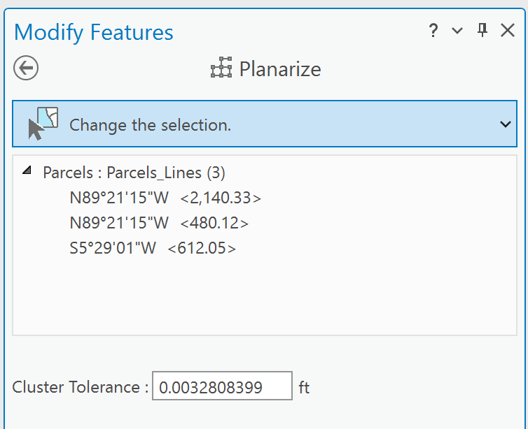

FrankConkling
If the distance between the endpoints are small enough, you can always use the planarize tool and set the cluster tolerance so that the endpoints snap together.
Frank Conkling - Panda Consulting
AndrewWallick
That's a great idea!
