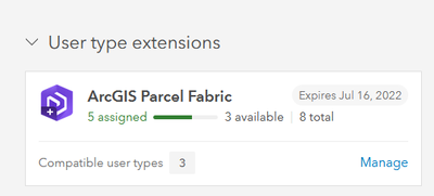

It should be available during the licensing process:
As far as I know, these add-ons are 1:1 with your Pro licenses.

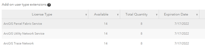

Where are you accessing that Add-on user type extensions table from?
jcarlson
MVP Esteemed Contributor
When generating a new licensing file for Portal via My Esri, it's on the same page as choosing the different counts of user types, Creator, Editor, Viewer, etc.
