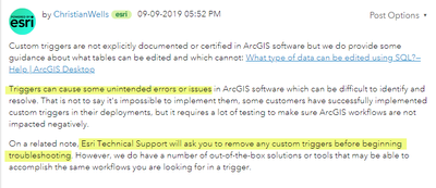

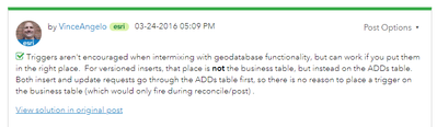

Adding your own DBMS triggers to your geodatabase is not recommended and not supported. It can get complicated in a versioned environment and can likely be replaced with Attribute Rules in ArcGIS Pro.
There are multiple posts about triggers like this one
and this one
