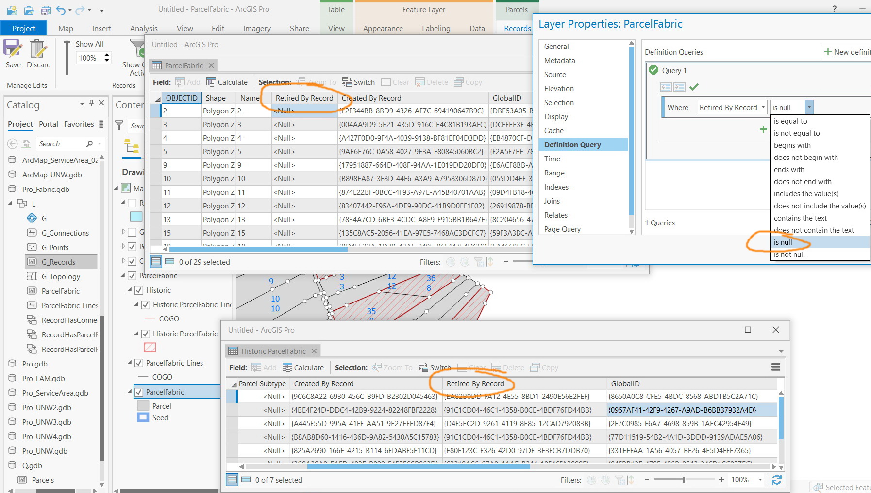

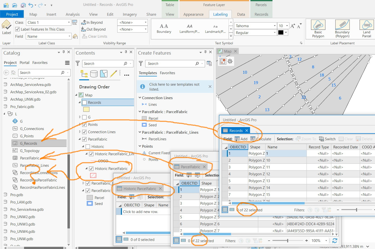

I couldn’t figure out where the “historic” feature class is stored in the fabric file geodatabase

In an ArcGIS Pro parcel fabric, parcel features are historic if the Retired By Record field is not null. Historic parcel features are displayed in Historic group layers under the parcel type layer. The Historic group layer has a historic line sublayer and a historic polygon sublayer The historic line and polygon sublayers both have a predefined Retired By Record is not null definition query.
... sort of retired...

Manty thanks Dan. Right, this layer is defined with "definition query"
