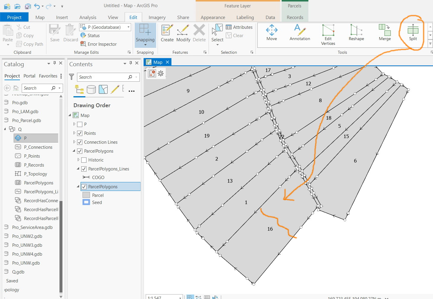

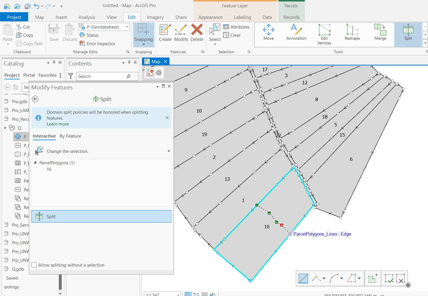

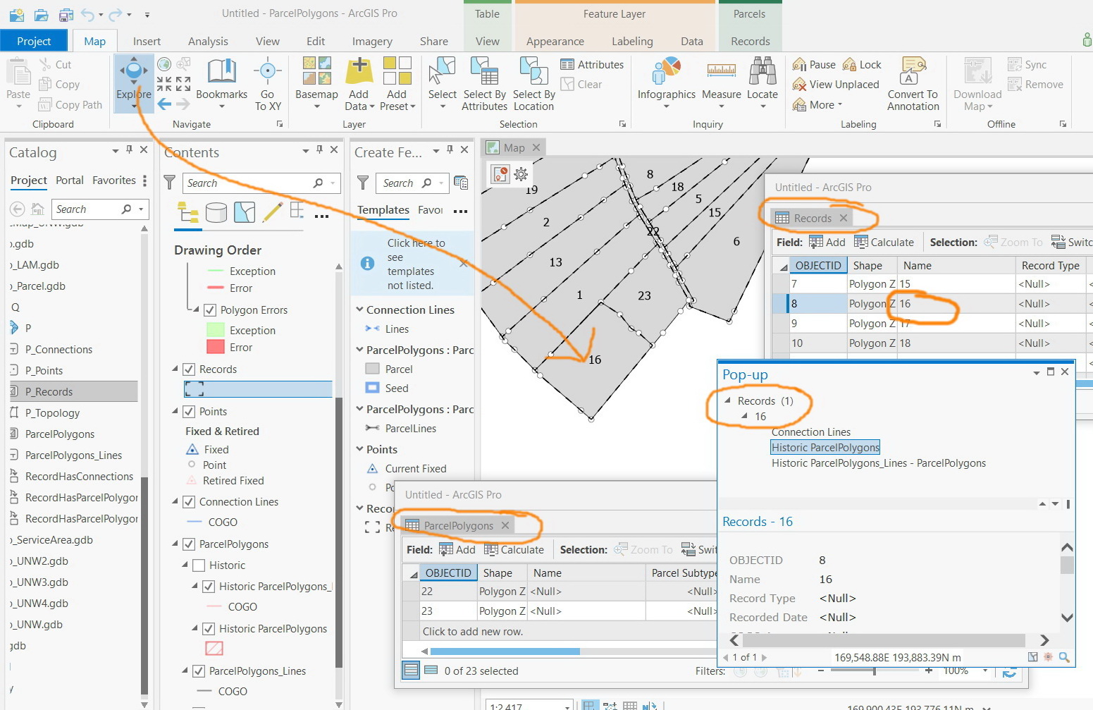

For example, in the screenshot below, the indicated parcel (#16) is split into two parcels. However, clicking one of the newly created parts doesn’t show its history as it used to be performed in ArcMap.
What might be the best practice to perform this sort of work?
