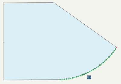

Examples
Scenario #1 - These are already individual arcs. Merge Boundaries will not do anything for these, so the tool appears to not work. The tool works properly after either running Densify on the features or manually changing them to 2-point straight lines.

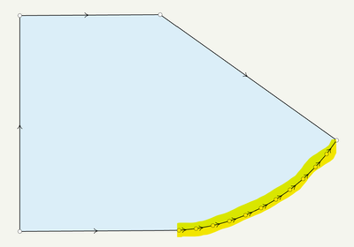

After running Densify, then Merge Boundaries, I get the expected single feature with densified vertices, and the orphaned parcel points are automatically removed.

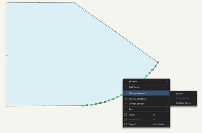

Scenario #2 - similar to #1 except we've already got a single feature, but each segment is an arc:
Running SLACA on this results in no change. Workaround is the same, either densify the line or manually set segments to straight lines, then run SLACA. After which we get the expected result:
Another issue with these workarounds is you have to do this for all lines and polygons affected (for polys it's probably easier to shrink/reconstruct)
