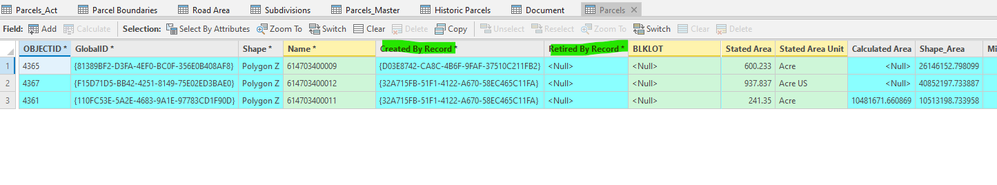

For me the attribute table is where this issue exists.  But really any where the Record GUID appears in the context of a parcel or parcel line.  i.e. retired by: Record Number or name created by: Record Number or Name is more useful information to display in my workflow than the Record GUID.  Historic Parcels same story.  I think it should be the default behavior, as the Parcel Fabric is Records-Driven and as a user,  I certainly care more about  the Name/Number I have assigned a record than the Record GUID that the system assigns for me automatically.
Below in Green I have highlighted a sample of my table of the field view. It's my parcel layer.
