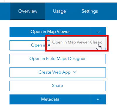

Ok, I found a workaround. Seems ESRI's really trying to get us to not use the classic map viewer. They've moved the option to open it to the Overview page for the web map.
So, I can still open my old web maps in the classic map viewer and make edits. And yes, I do know that I have to migrate them to the new map viewer before the end of this year, and I'm working on doing that.
