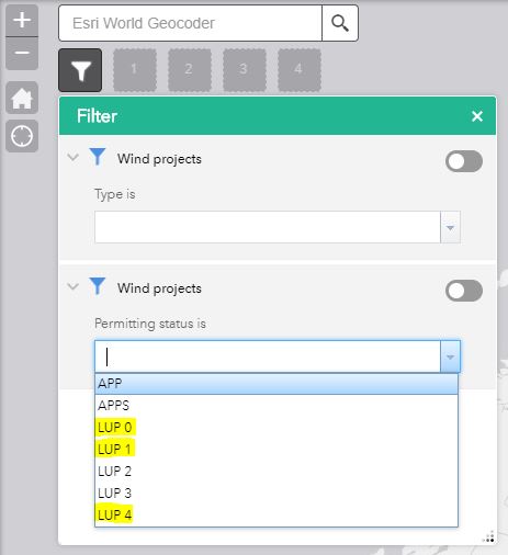

I'm not sure if this is the right topic, but I'm struggling to create a web app with several filters (for one point layer) that would allow the selection of ZERO, 1, more than one or ALL of the unique values. For example I'd like to create a filter that would select from the Permitting status any of the unique values or any combination of these unique values (for example LUP 0, LUP 1 and LUP 4 as in the attached screenshot). Can it be done?
Thanks,
Marius

It would be best to branch this to a new question. You can define a set of expressions combined with the OR statement to filter based on multiple values in the same field as explained in this post further up: https://community.esri.com/thread/202483-why-is-it-so-hard-to-apply-interactive-filters-in-agol#comm... . I don't think selecting none or all would be very functional (providing there are no empty values) since it would show none or all features.
It would be a great addition to have something as a multi select to show only the features that match the selected values in a single control without the need to create multiple controls.

MariusKokko
In case of, let's say 10 filters, with 10 unique values in each filter the solution above would be if not impossible to do, at least very tedious to configure and use.
Multiselection with a tickbox or something would be nice.

Hi Marius,
You may want to look into Operations Dashboard for ArcGIS, specifically its actions framework and selector functionality. This might address your needs.
Hope this helps,
