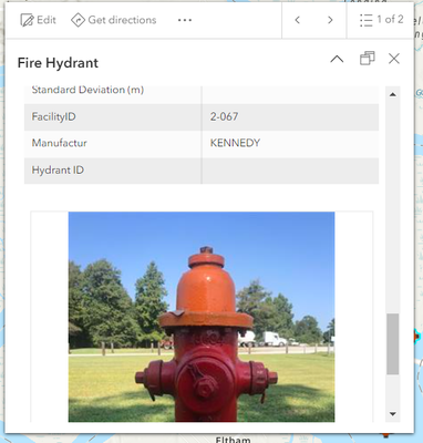

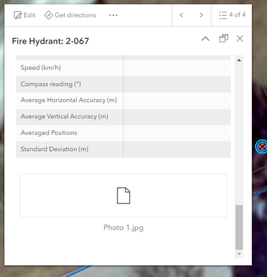

Why does my attached image not show within my Pop-up? The image is there it requires me to download the image.
1810
7
09-20-2023 01:48 PM
WalterFeurer
I have performed this before with success and the image shows within the Pop-up.

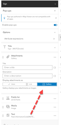

In the popup config, do you have the "Display Attachments As" set to Gallery?
R_
WalterFeurer
Thank you so much for responding, yes I have "Gallery" set.WalterFeurer_0-1695502219035.png

Was there any solution here?  I am experiencing the same issues.  Geodatabase attachment images (.jpg) included with the layer when shared through Pro only show as links even when in Gallery mode.   If I add additional images through AGOL those will show up correctly as inline images.

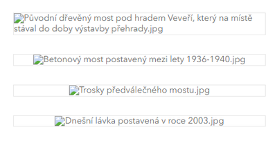

I have similar issue. My data are referenced from enterprise geodatabase. It has problem in pop-up at Portal and AGOL and in Feature Info widget in ExB.
Here is image, how it looks like:

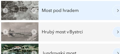

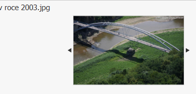

In ArcGIS Pro it works correctly:
And it also display great in Image Widget in ExB:
