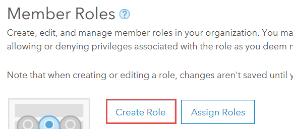

  1. Log in to ArcGIS Online, and click Organization > Settings > Member Roles.
  2. Click the Create Role option, and create a new role for the user. Refer to ArcGIS Online: Configure member roles for more information.colab.png

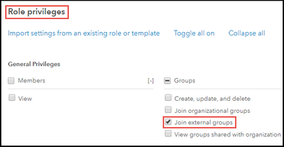

  4. Under Role privileges, check the Join external groups check box to enable the user to join a different ArcGIS Online organization group. Click Save role > Save.colab_2.png
