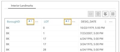

It looks like it's sorting by multiple columns, with the numbers indicating the sorting order, first by the field "Stadt..." then by "Anzahl...".
KenBuja
MVP Esteemed Contributor
This is a new enhancement, as detailed in the What's New blog
Table
It is now possible to sort a table with multiple fields at the same time using multi-level sorting. In the example below, the table is first sorted by the BoroughID field, then by the number of LOT.
