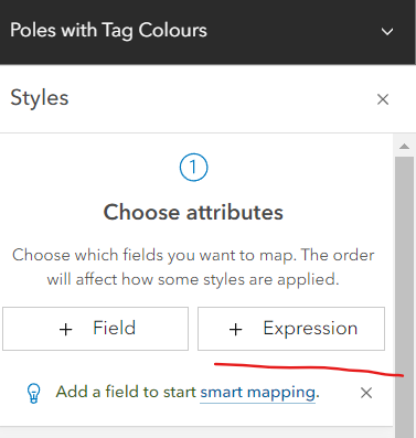

Hi @GregReinecke ,
Would it work if you set the symbology of the layer using a similar arcade expression.
Applying the expression should give you 2 categories.
The feature captured in the current week would have a proper symbol the other that do not fit the criteria would have the symbol size set to 0.

GregReinecke
That would do it. Thanks so much.
