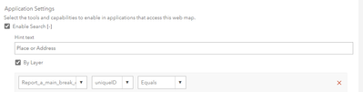

Hello,
I'm trying to use a URL parameter to search out a uniqueID and highlight the feature in a webmap with a URL parameter that use dot work for a webmap build in "classic".
The uniqueID is created as a string using #Survey123.
The webmap has the uniqueID field included in its searchable layers.
However, the url parameter shown below now no longer works since migrating the map to the new map viewer:
https://xxxxxx.maps.arcgis.com/home/webmap/viewer.html?webmap=cxxxxxxxxx9?find=0xxxxxx5

hmmm...OK, thanks @RussRoberts  for sending me down the right path. So this was interesting. Here's my theory:
  1. Before posting this thread I had manually edited my webmaps JSON to include ObjectID and GlobalID as search parameters in an attempt to use those:
"search": {
"disablePlaceFinder": false,
"enabled": true,
"hintText": "Place or Address",
"layers": [
{"field": {
"exactMatch": true,
"name": "objectid",
"type": "esriFieldTypeOID"
"id": "xxxxxxxxx"
"field": {
"exactMatch": true,
"name": "globalid",
"type": "esriFieldTypeGlobalID"
"id": "xxxxxxxx"
2. Once they failed to work I established a UniqueID calc’d through Survey123.
3. I updated the webmap to use that in it’s search criteria instead. But it never did. Hence this post.
4. Upon checking the JSON for the webmap it appears that, perhaps by previously manually editing it,  step #3 above never took. And the webmap never actually had my UniqueID set as a search criteria in it’s JSON, despite showing me it did through AGOL GUI.
5. I manually removed ObjectID and GlobalID from the JSON, and manually added in UniqueID….voila! it works.
