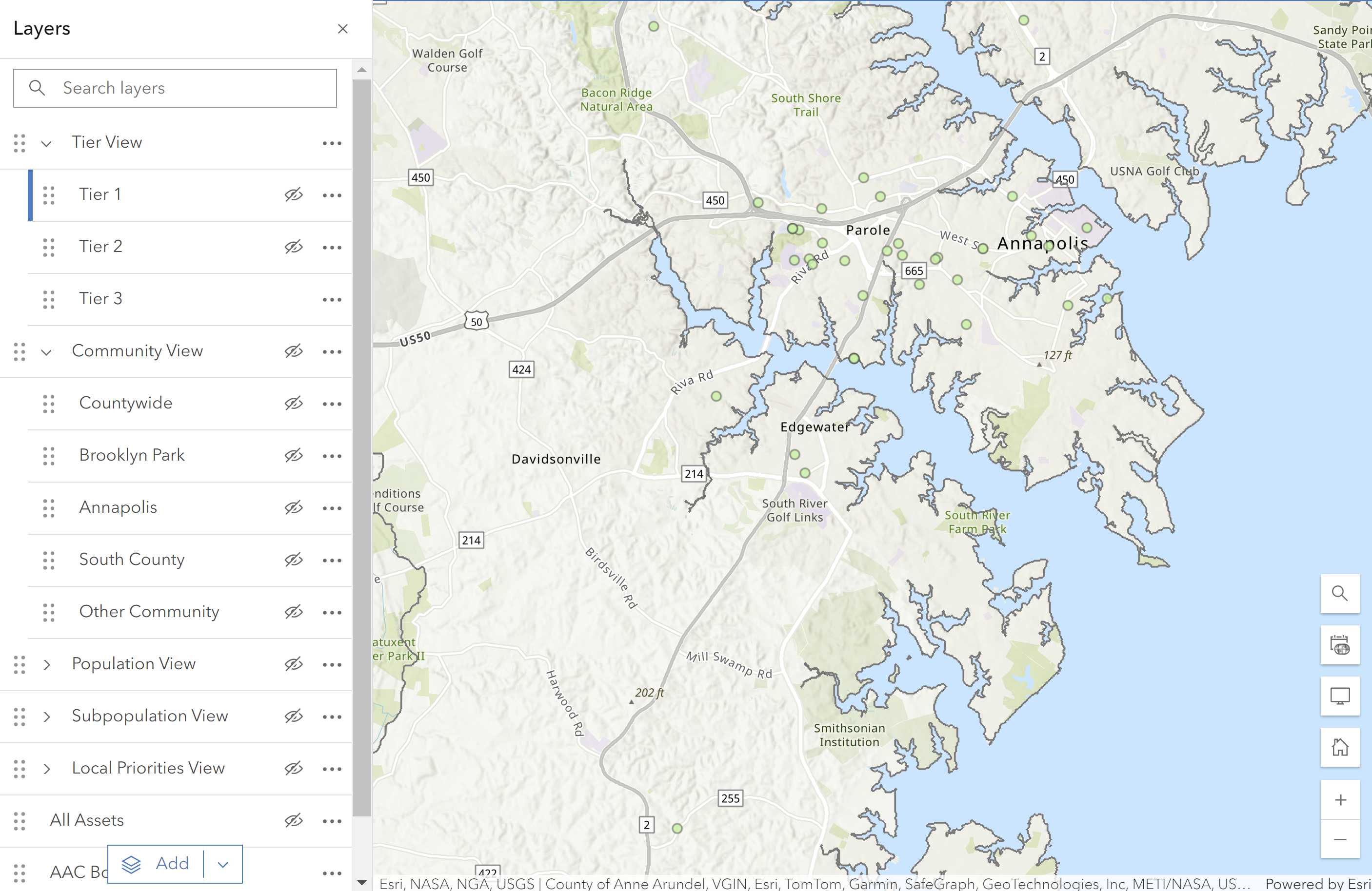

Hello! I've recently had a problem where I incorrectly exported my coordinates from my geoapfiy, and many of my points showed up in incorrect positions on my webmap. I'd already submitted the webmap when I noticed, so I now need to be able to update these coordinates without accidentally altering the webmap url that I had submitted. I went into the Edit Feature mode in the webmap and manually edited the fields, but this doesn't seem to change the actual point locations. Does anyone know how to do this without manually resnapping each point?

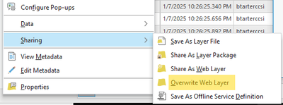

If I created a feature layer with incorrect point geometry but I had access to the correct coordinates via fields in the same feature, I would use the XY Table To Point geoprocessing tool in ArcGIS Pro to create a new feature class using those coordinates.
Then I would share the new feature class as a web layer by overwriting the existing web layer, which would preserve your URL to the hosted feature layer.

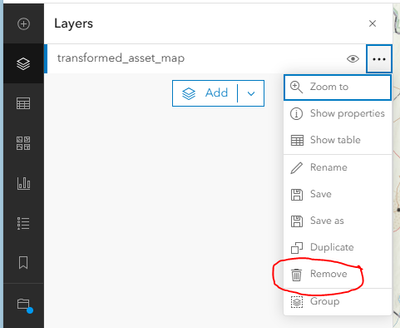

What URL are you sharing? The URL to the map or the URL to the Feature Service?
It sounds like you've shared the URL to the map. That means you can remove and add layers to that map as much as you want without changing the URL.

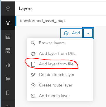

I would remove the layer with the incorrect points from the map (this does not delete it from your portal so you can get it back if you need to). Then create a new layer using the corrected CSV. Add the new layer as a file like in this image:
This may be the way you added the layers originally. Just follow the steps and make sure the correct fields are used when it prompts for lat/long or addresses.
Let me know if this makes sense or I am misunderstanding your issue.
