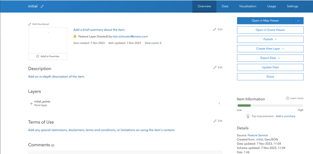

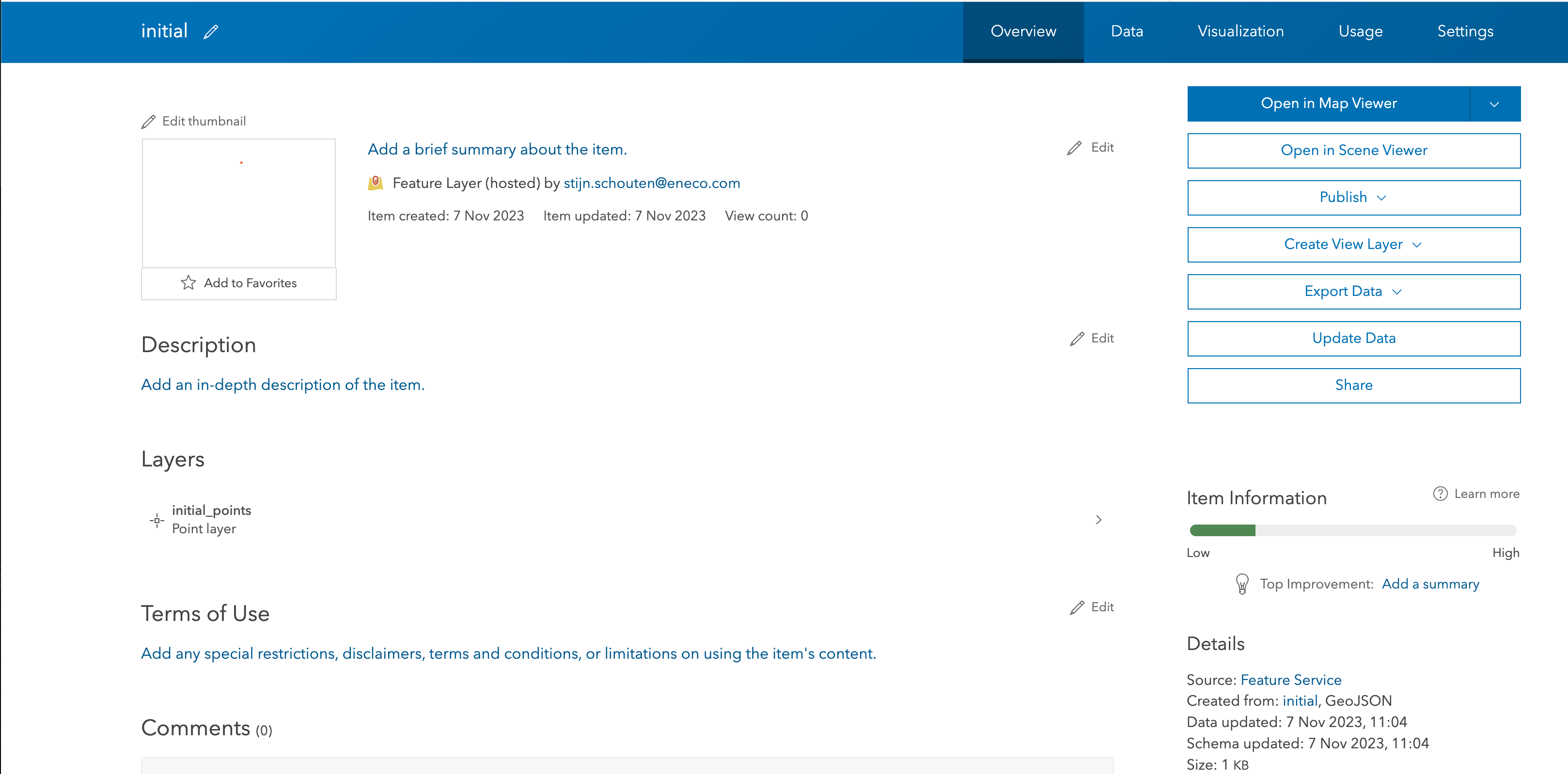

In the attached .zip (it is all public data) there is a .json file called 'initial.json'. Im using this as a sort of schema definition for the layer. I'm uploading this to AGO and publishing the layer as hosted feature layer. So far so good
 (single feature)

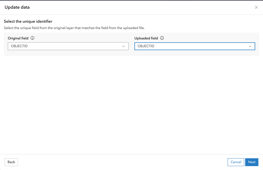

I'm using the "Update Data" button of the hosted feature layer:

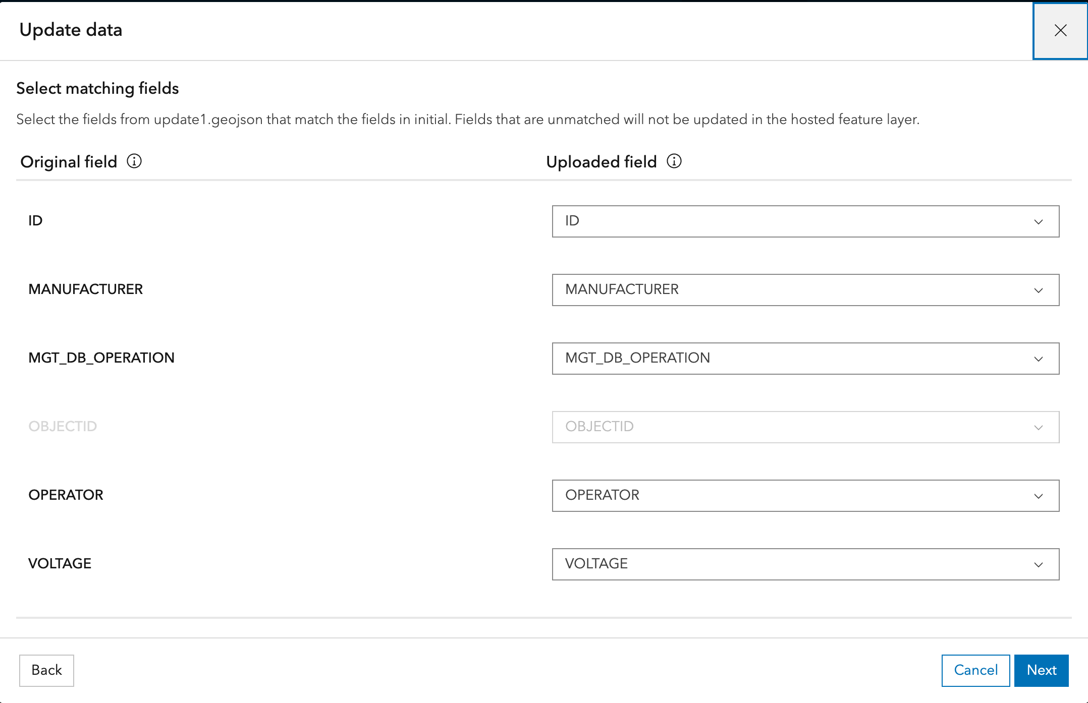

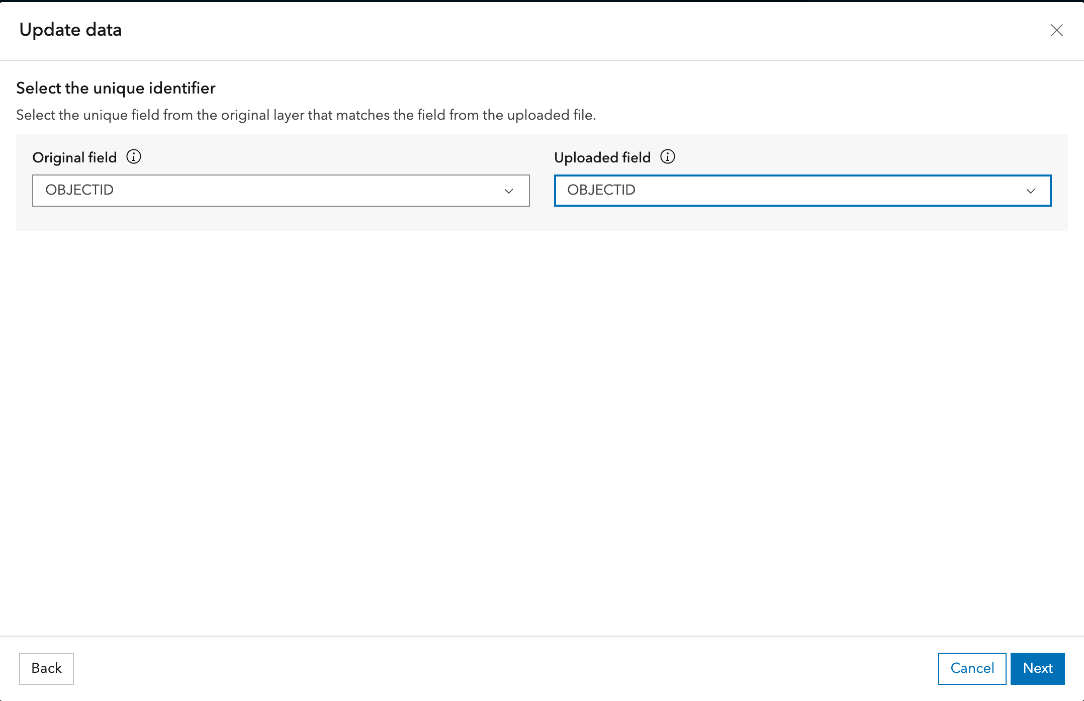

Uploading "update1.geojson" and setting the identifier as such:
And letting AGO do the mapping for me

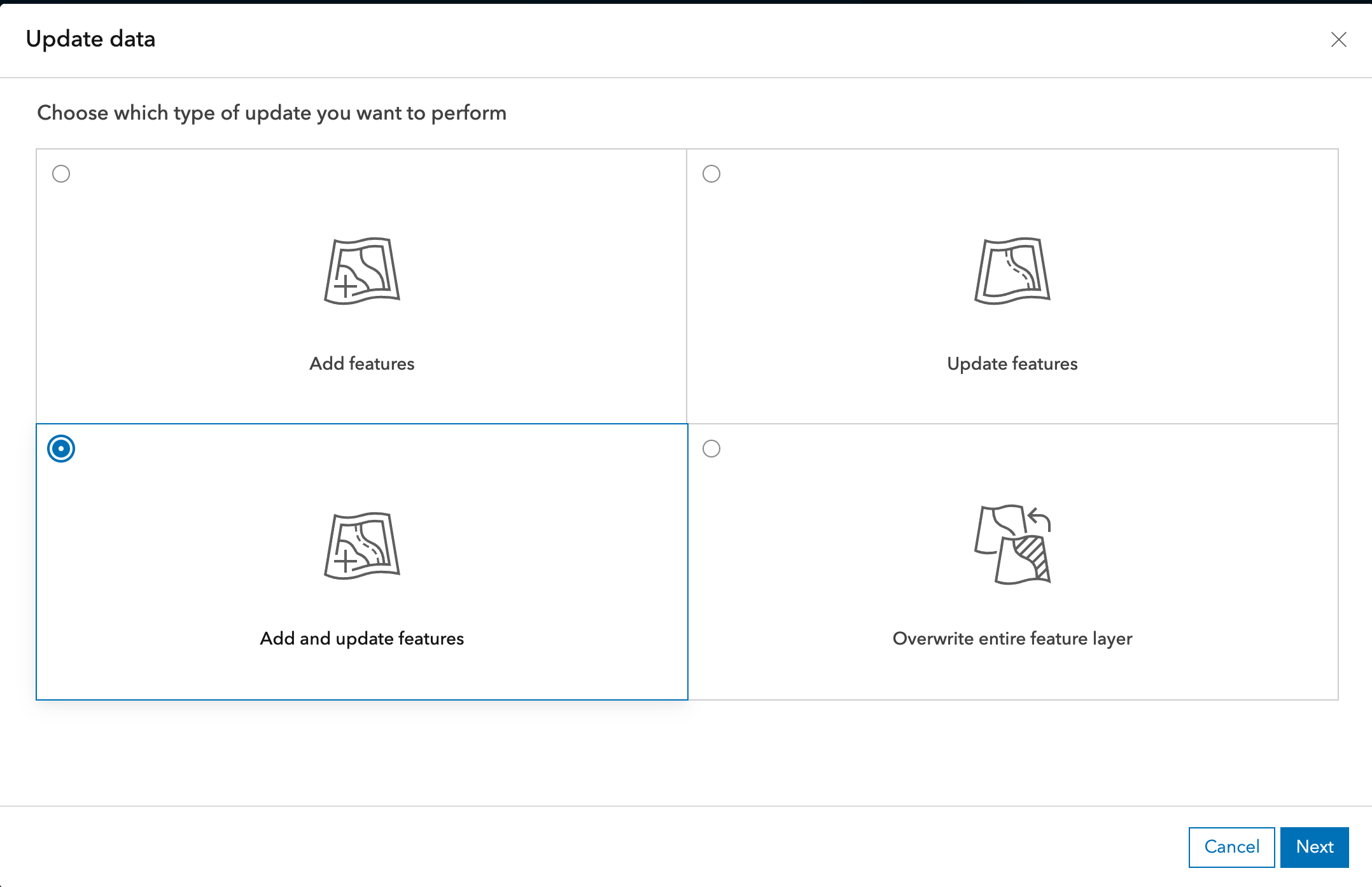

I click <next> and select the option to update Attributes and Geometries

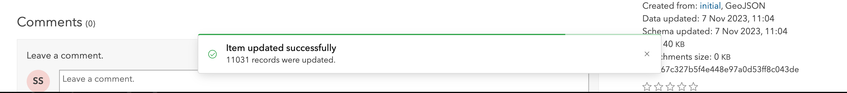

AGO will then process the file and mention that the layer has been successfully updated with 11031 new features:

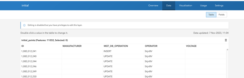

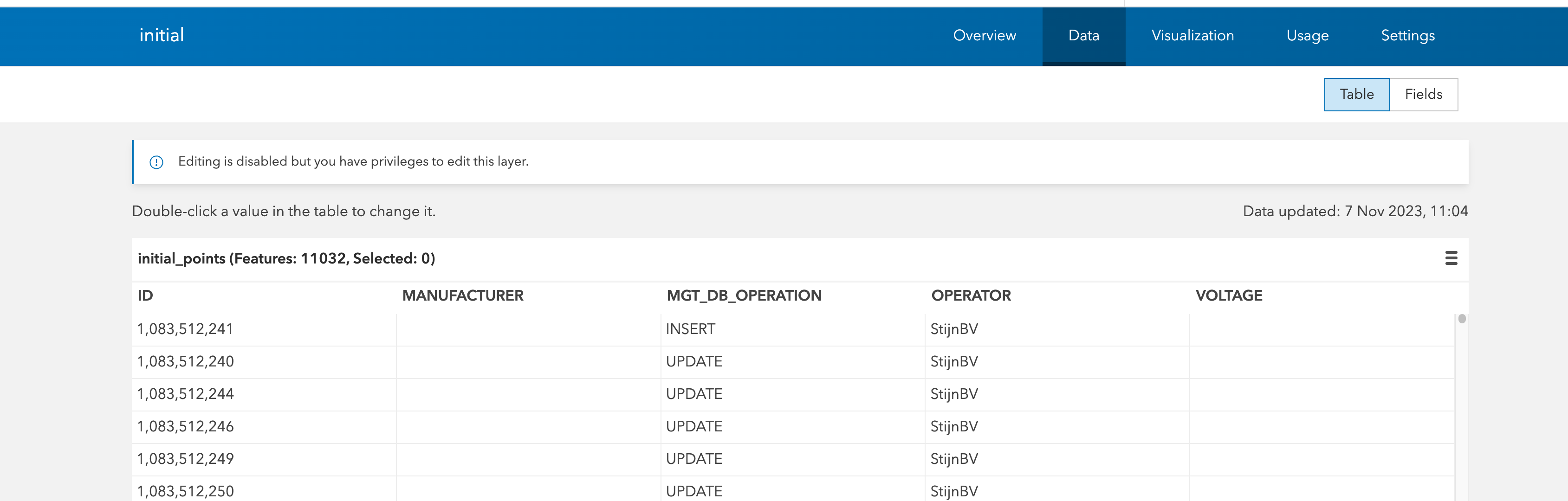

When i check the data tab it is reading 11032 features! So this is also going well:

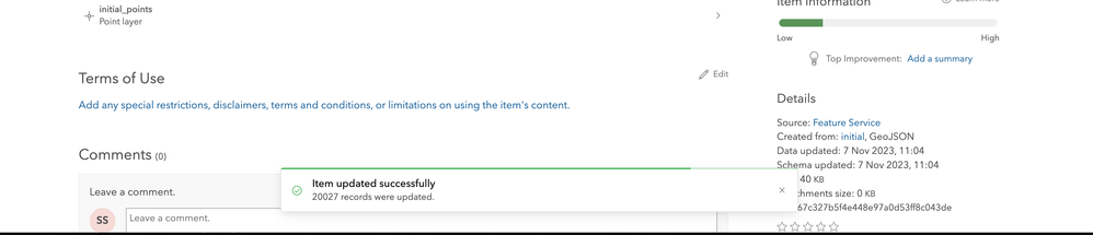

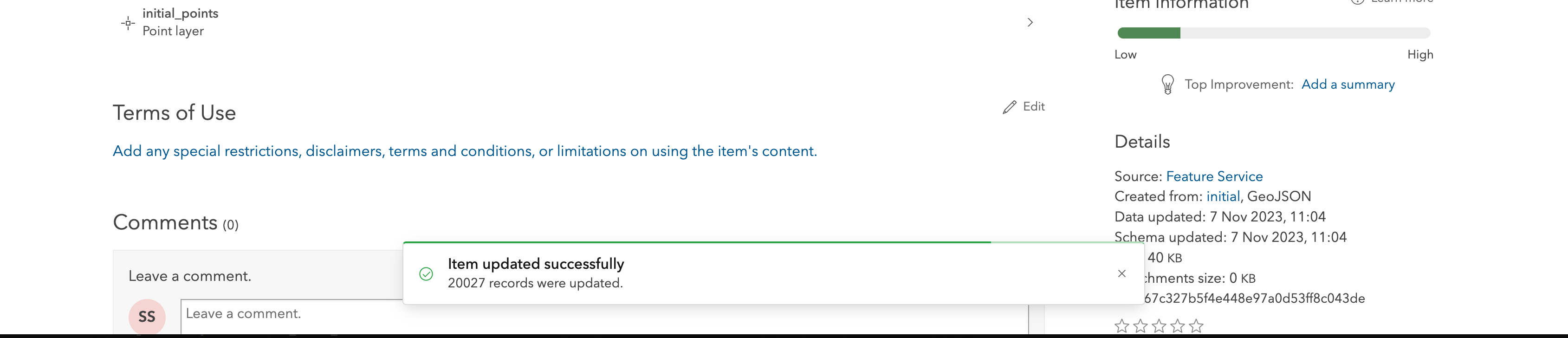

I do the same for "update2.geojson". With also the same success message:

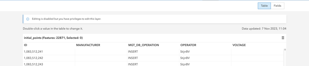

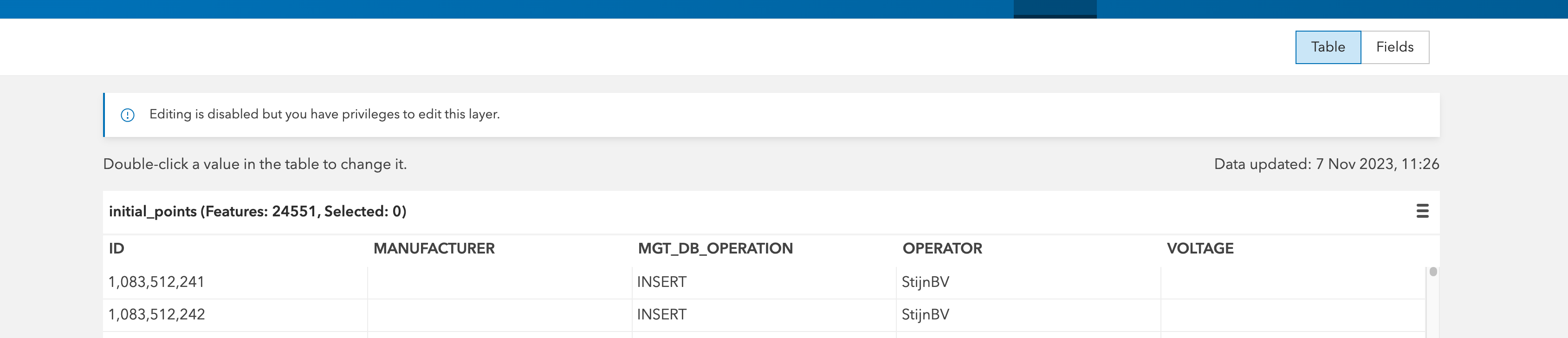

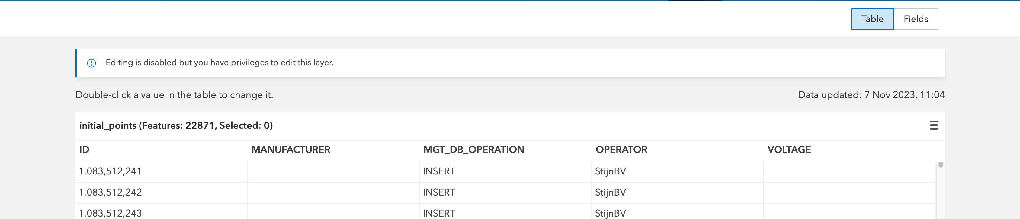

So logically the total count should be 31058 right? Wrong:
I've checked that the objectid's are unique and that the geometries are valid. I've checked this with JSON To Features in ArcGIS Pro.

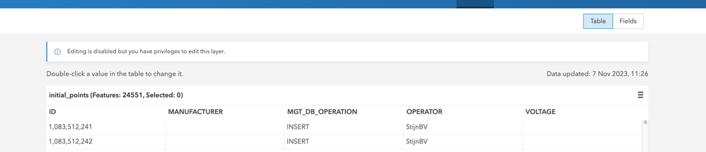

Swapping the order (first update2 then update1) results in a slightly different total amount:
As it first fully uploads the first geojson file and then partially uploads the second geojson file. So it seems that the problem is not in the quality of the geojson files but in the order which seems even stranger to me.
