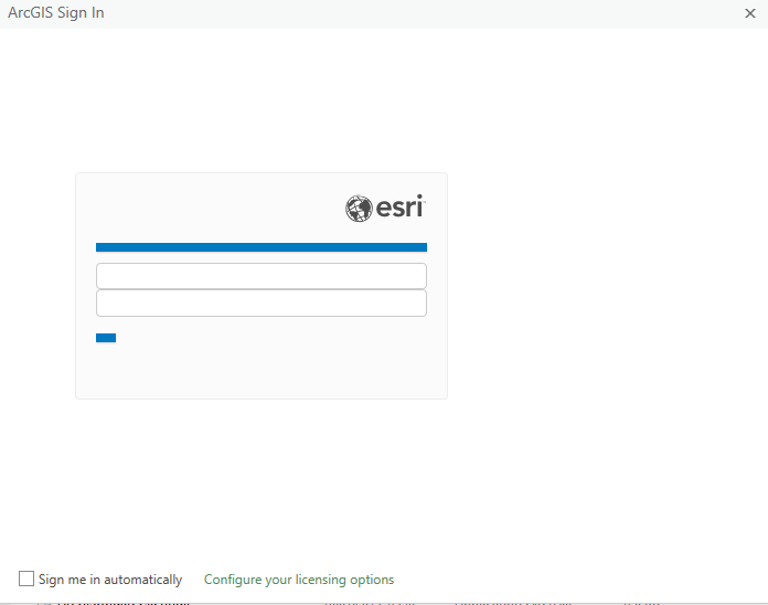

So yesterday I wanted to change my associated portal in ArcGIS Pro, and I hit sign out ( Instead of manage portals).
Then ArcGIS Pro froze, and I had to force kill the application. When I try to open ArcGIS Pro  I come to this window:
 Sign in
You can see right away something is odd with this window, but I try it anyway.

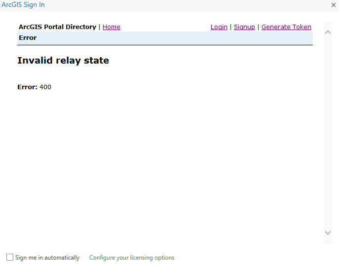

When I add my credentials I come to this window:
Sign in error
As you can see from the purple colors, I have tried everything here.

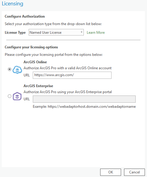

On the configure license options I have asserted correct settings:
Configure options
I believe if I had a server registered with ArcGIS Pro Advanced licenses, I could do a Concurrent Use License, but my license is a Named User License.

Thanks to our support team we manage to locate the problem.
My internet settings for security was set to high. So the system was partly blocking the connection.
changing the security settings to medium fixed my problem:
