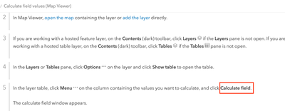

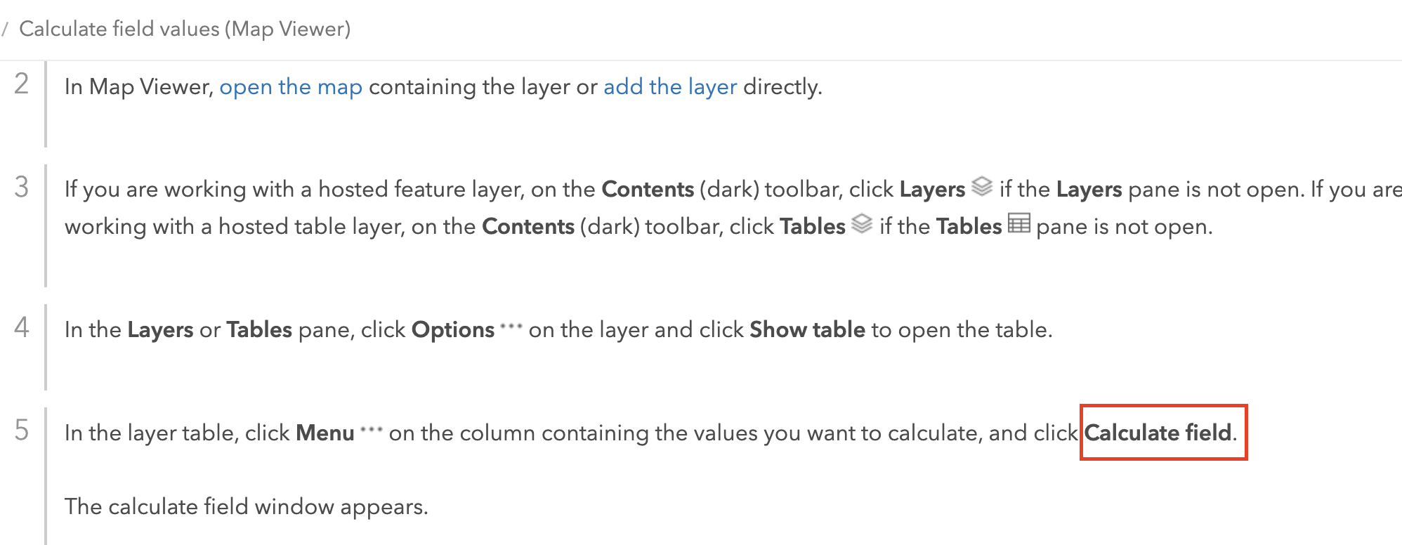

I am working with data that is in decimal form that needs to be converted to whole numbers. I am following the instructions from the page Calculate field values (Map Viewer). The 5th step tells me to click on the menu in the column containing the values I want to calculate, then click the option for "Calculate field".

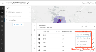

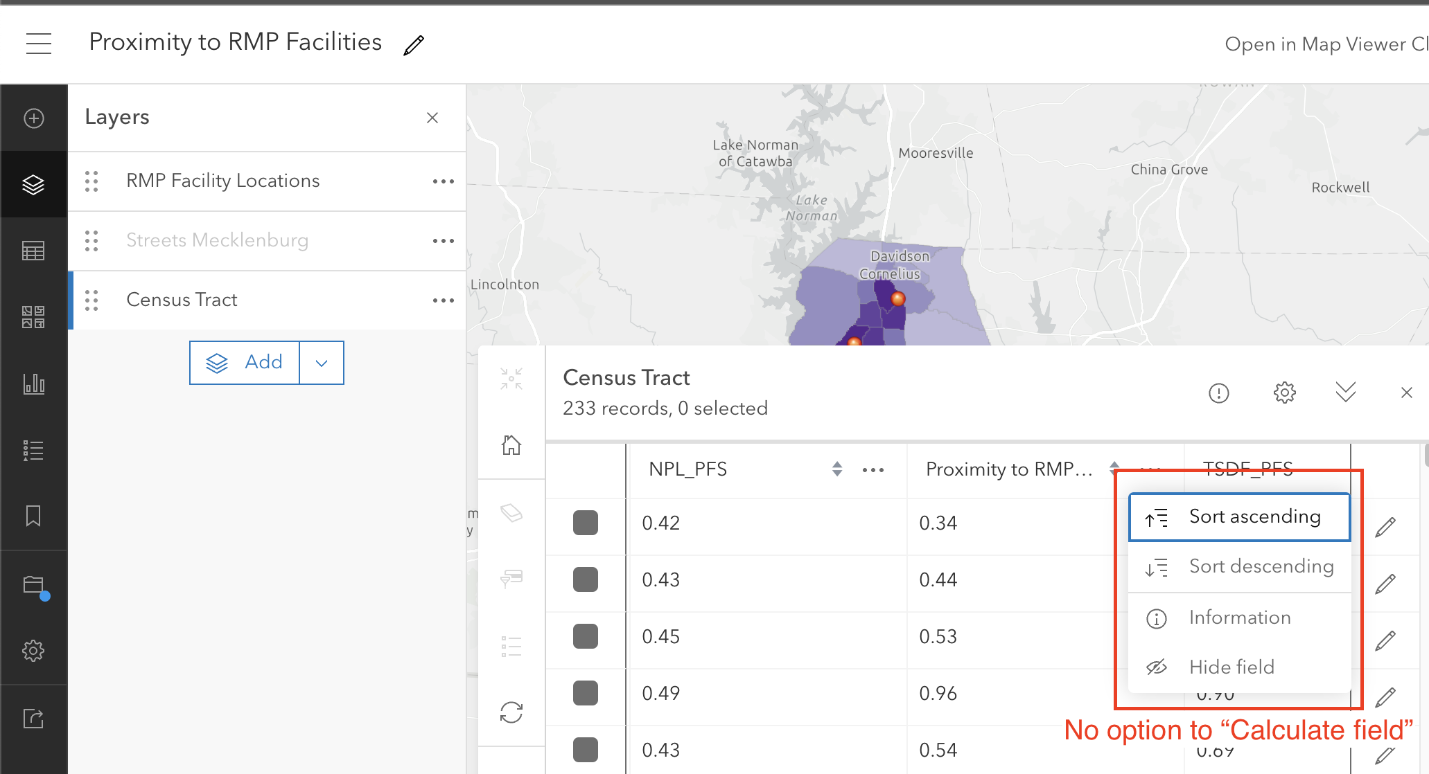

The problem is that I do not see an option to "Calculate field". This is what my screen looks like when I try to find this option:
I am using a 2020 MacBook Pro. Could this be an issue with the laptop? Should I try using a desktop computer? Could this be an issue with my assigned privileges?

hi @MayaFleagle you have to be the owner or admin of a dataset to calculate it. Do you have those privileges

@MayaFleagleyes it would be the owner of the original item you derived it from. You can also contact your organization admin as well!
