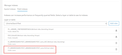

On the underlying 'LibrariesSearchTest' hosted feature layer the Full text index has been built for the 'name' attribute (this was created automatically):

With a Contains search the main issue seems to be that certain words/characters/phrases aren't indexed as part of the Full text index (although I can't find anything in the docs) which means including words like 'the' or 'and' (or characters such as '&' or an apostrophe) in the search field stops the search function from returning anything.
