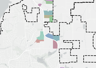

I have REST service that feeds several layers in an AGOL web map. One of the layers has 500+ features that need to be individually symbolized. Because of this we've chosen to symbolize them on the desktop side, instead of symbolizing them from AGOL. New features are constantly being added to this layer and need to show up on the map with their own unique symbology. We refresh the symbology and then republish the service. On the AGOL side, the new features show up, but they have the generic default (all other values) symbology, instead of the unique symbology they should have.
What have I done wrong here?

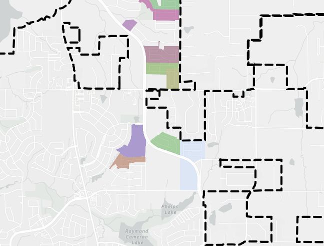

What it should look like:

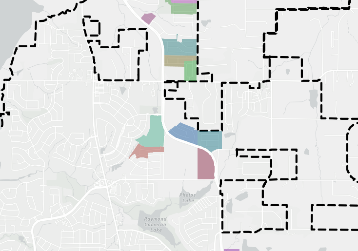

What it DOES look like:
If I re-add the layer to the map, it "fixes" it, but there are filters and other edits made to the layer. That layer also feeds a dashboard, and I would have to reconfigure the dashboard each time a change is made, which is not going to happen.
