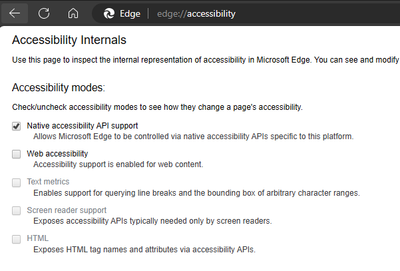

eryildiz
This is the workaround that we got from Esri Support . We tested and it worked.
  1. Open a new Chrome Tab and launch chrome://accessibility.
  2. Disable/uncheck Web accessibility and leave the Accessibility Tab open.
  3. Open a new Tab and try to load Portal and then the Groups Tab.

BryanBoutz1
Thank you for sharing! This did appear to work for me in Edge.
