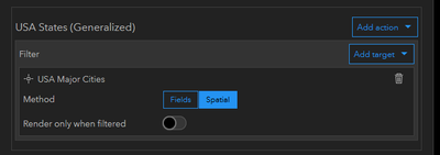

In the map widget settings, go to Layer Actions. For your polygon layer, select Add action → Filter. Select the other layer you want to be filtered, and set the Method to Spatial.

As you can see in the image I attached to this question, I could not see "Render only when Filtered" option.  The polygon layer is a FeatureLayer. And when I tried to open the polygon layer using ArcGIS online MapViewer it said "The layer 'POLYGON' is not accessible by ArcGIS Enterprise. Thus, editing will be disabled on this layer". Is that the reason I could not apply Spatial Query?

You would configure this in the Map element > Configure > Layer Actions. It looks like you're in the correct configuration dialog.
I just tested this capability and the spatial query between layers is working for me. What error or issue are you seeing?
DInavolu
When I selected Spatial option in the configure dialog, it showed nothing to apply filter.
