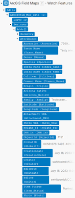

swhitcombMCC
This seems like the solution I need, but I can't find attachmentInfo in the list on Make. Searching the list for "attachmentid" turns up nothing. Did I miss a step somewhere?
Here are all the items that come up when I try to add an item to the File URL box:
Also, the URL for my attachments includes a token at the end. Will that be an issue?
