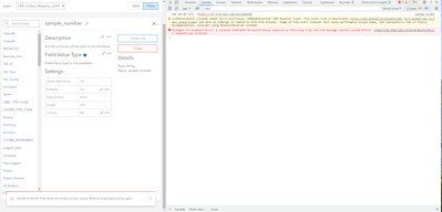

hello i'm having a similar issues but the problem is that i can't enable the option for unique values, show an error that said that i have duplicate value, i take a screenshot for the console in chrome, i saw in the conversation some ask for that.
