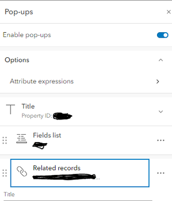

Hi all,
I am following this blog post: https://www.esri.com/arcgis-blog/products/arcgis-online/mapping/introducing-related-record-editing-i...
In my Forms I see the new 'Related records' element at the bottom. Unfortunately, when I expand the arrow down, I see "No related records available. Create new related records in ArcGIS Pro'.
Well that's not true because I have a related record and I also configured to see it in my pop ups!
soo, is this a bug? or anyone else have this problem and a way to solve it?
Thank you,
Andrea

@AndreaB_ were you able to configure portal related data feature service in AGOL map? attempted that but limited success on my end.
when using portal related data feature service in AGO map, in the form builder, i dont see the "related records" section to configure the form for the related table.

I understand the direction matters and inmy case the origin is the feature and destination is table.  to be clear here are the steps I took
1. create relationship class in pro ( feature origin and table destination : one to many )
2. published that to portal for arcgis 10.9.1
3. add the url of that published feature layer with related table in AGOL map ( not portal map)
4. go to forms section in agol map and no related records as it is shown in my screen capture of previous comment
on the other hand
2. publish it to AGOL
4. go to forms section in agol map and now I am able to see the related record section and ready to config the form
So, using portal hosted relationship class in agol map to configure form ultimately to edit the relationship isn't supported?
