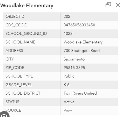

I have linked 3 related tables to my feature layer. All of my feature layer attribute data shows up on level one of the pop up, but I have to click into the related data to view the related information. Is there a way to configure the pop up so that the data for the related tables in not on another level, rather the pop up displays all the related data the same pop up level?

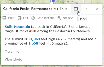

Could you send a screenshot of the popup? This may just be because they are separated into different "Column" formats, so it shows up that they're different, instead, you may be able to create a Text entry, and then build your popup on just one level, something like this:
vs this:
