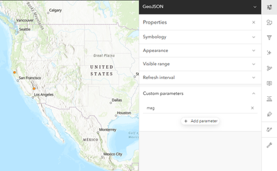

You could add a GeoJSON url to New Map Viewer and can update the custom parameters from within the map viewer.

Correct you are just looking at the hosted feature layer. If you wanted to use just the GeoJSON then you would do the Map Viewer - GeoJSON by reference.
