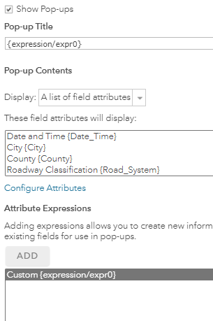

How do I change the format of a numeric value in a Pop-up Title?  I would like to get rid of the comma separators and decimal places.

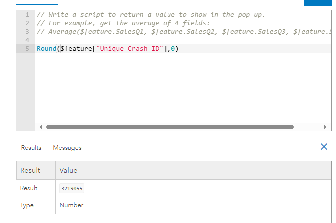

I tried a custom Arcade expression (when I test it, the results are correct), but it is not reflected in the title.
Here's how I have the custom expression input in the Pop-up Title bar:

Actually, figured it out myself - converted it to text using this expression:
Text($feature["Unique_Crash_ID"],'########')

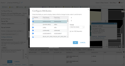

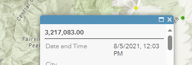

Another way to do this In Map Viewer Classic is to format the field in the Configure Popup dialog. Click on the "Configure Attributes" link, select the field, use the dropdown to set the decimal places to 0,
and unclick the "Use 1000 Separator" checkbox.

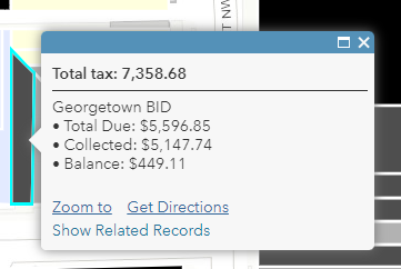

Here's an example showing that it does work. This is using the field ANNUALTAX. This shows the popup with two decimal places and a 1000s separator.

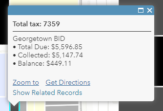

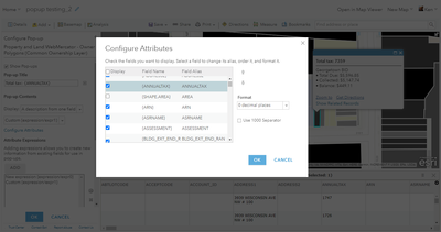

Then I changed the decimal places to 0 and turned off the separator.

Interesting.  I had initially tried that (much easier than building the expression) but for some reason that did not work with my data, at that point at least.  Haven't re-tested, but it seems like your solution works as well.   Thanks!
