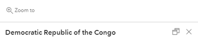

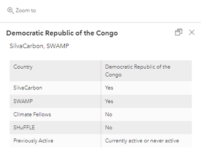

It works in Map Viewer, but only if a field list follows it:
I don't want a field list, but when I remove it, the expression no longer works, it just doesn't show up:
 @NW_-_MikeCibicki__GISS_ suggested I try it in Map Viewer Classic and it works there. Seems like a bug?
