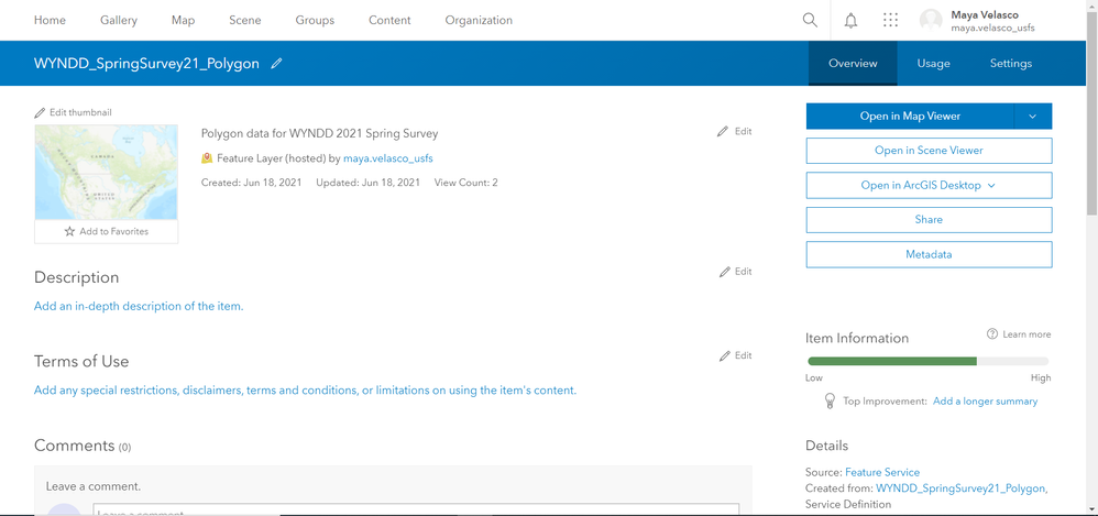

I actually don't see the data and visualization tabs on in the polygon feature layer like I do with the points and lines. Attached is a screenshot.
I tried in chrome and edge, but the same problem happened. I didn't see any warning when publishing and have deleted and republished multiple times.
I will check the coordinate system though.
JayantaPoddar
MVP Alum
That's a bit strange. As the owner of the item, you should be able to see those tabs. Also the number of "action item" buttons are less. Something didn't go through right.
