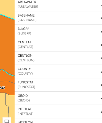

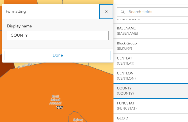

I have a few novice questions about overwriting an existing feature service with an updated layer from Pro.

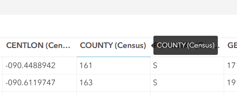

I went through my local version of the layer, reordered my fields, realiased many of them, and deleted others. I did not change any field names. I overwrote the online version of the layer successfully -- when I open the data tab on the item detail page, I'm looking at a table with the new field names and the old fields removed.
Ex. I added (Census) to the fields originating from the Census.
So far so good.

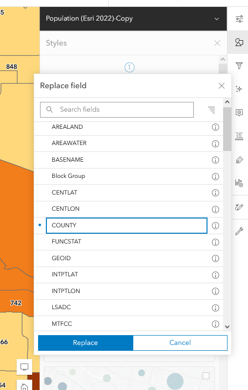

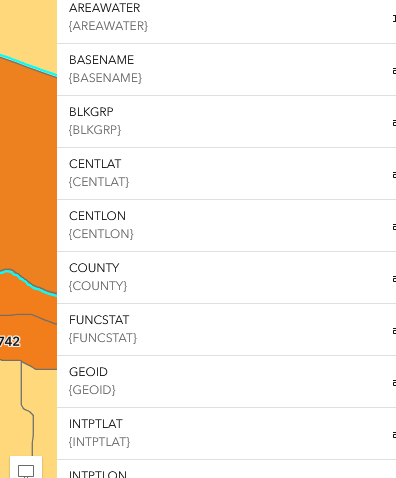

I start to run into problems in New Map Viewer where I have begun creating a map with the layer. From this help article, I understand that things like symbology will be pointing to the old fields still and I'll need to update that -- but when I click Fields on the right toolbar, it still shows me a list of my old fields.
Same when I go to symbology.

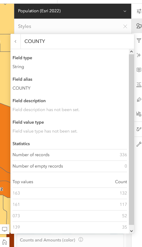

And after resetting to source layer properties -- same thing.
If I add a new copy of the layer, it shows the new fields, but no aliases.
Just seeking some clarity on what's going on here and how I might remedy without reconfiguring -- I have about a dozen copies of this layer in the map each with unique symbology, labeling, and pop-ups. In regard to those things, the layers still seem to be working properly, but I'd like to further modify my pop-ups and labeling which is difficult when I'm seeing extraneous, deleted fields and indiscernible non-aliased field names.
wayfaringrob
Honored Contributor

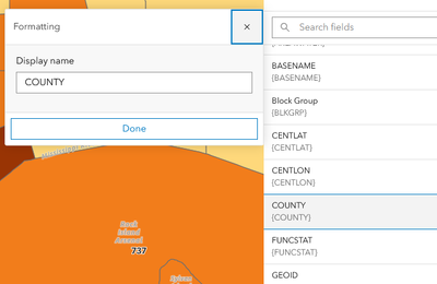

Ok - I see where I went wrong in AGO assistant, changing the item ID but not the URL. But now that I've updated the URL, some fields picked up their new aliases, but not others. This seems to be because they have their own properties defined in the map, but these properties don't reset when resetting the layer back to its source properties. Nor do fields show up in the list of properties stored in the web map when accessed in the Information section of NMV -- but when you look at "fieldsinfos" in AGO assistant, they absolutely are: field names, aliases, digit separators, and decimal places are stored there and thus override any user-visible settings. I've gone through and deleted everything except my attribute expressions and I am back in business.

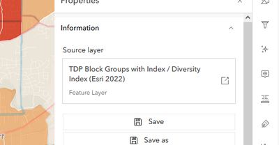

Ok - this is super weird. I did use AGO assistant previously to update the source of several of these layers from an old feature service ("BlockGroups_Enriched_4co") to a new one ("TDP Block Groups with Index") and in fact, the new layer shows up as the source when I view this information in New Map Viewer:
