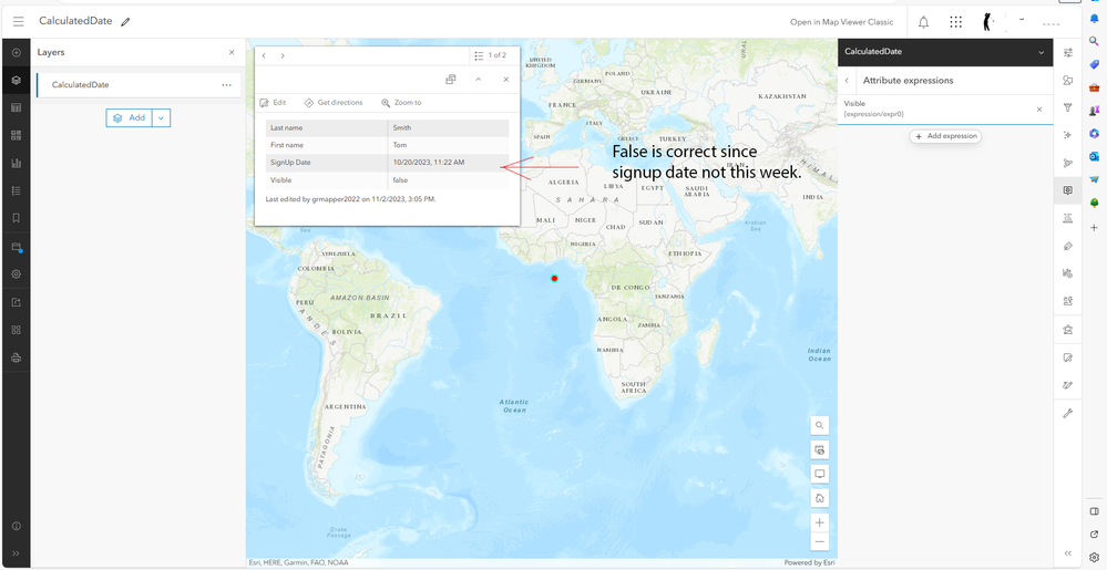

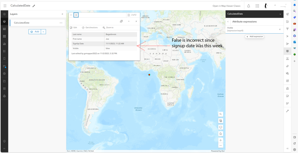

I started getting some code together. I have two features, one from a previous week and one from this week.
The feature last week generates a boolean "false" which makes sense based on the signup date.
The second point has a signup date of yesterday which I would think would prove out to be "true" but it doesn't.
Perhaps it could be due to the way the date is formatted.  Here is the code if anyone wants a look.
var now = Now();
var timeZoneOffsetHours = -5; // Eastern Time is UTC-5
// Adjust the current date and time to Eastern Time
var easternNow = DateAdd(now, timeZoneOffsetHours, "hour");
// Get the current day of the week and hour
var dayOfWeek = Weekday(easternNow);
var currentHour = Hour(easternNow);
// Define the time range for Sunday midnight to Thursday noon
var isWithinTimeRange = (dayOfWeek == 1 && currentHour >= 0) || // Sunday midnight
                       (dayOfWeek >= 2 && dayOfWeek <= 4); // Monday to Thursday
var isBeforeNoon = (dayOfWeek < 4) || (dayOfWeek == 4 && currentHour < 12); // Before Thursday noon
// Check if the feature's "_date_time" is within the specified time range
var featureCreationDate = $feature._date_time;
var isFeatureCreatedThisWeek = DateDiff(Week(easternNow), featureCreationDate, "day") >= 0;
return isWithinTimeRange && isBeforeNoon && isFeatureCreatedThisWeek;

Still searching….     Is it possible Now() and
featureCreationDate
 actually have a different output format/structure so they always compare as false?  Thanks to all in advance.
