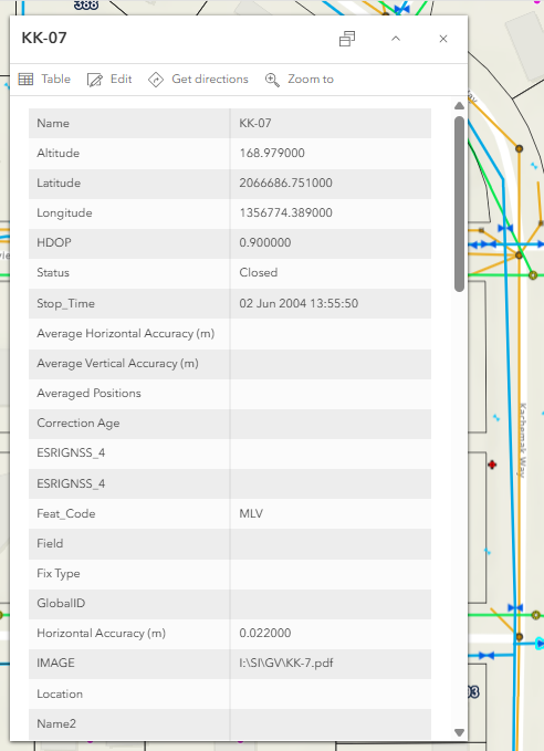

For this point, I would like the following pop-up window to omit all the empty rows (red slashes).
Can someone help me with this appropriate arcade expression?

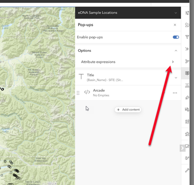

Is there anything under the Attribute Expressions section:
R_
WFCAdmin
Yeah, it's empty, no expressions saved there.

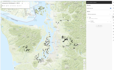

Its bizzar. The first time I load up the web map the popups work perfectly. Then, if I click on a second point - nothing, just the title pops up.
WFCAdmin
Even more weird. If I click on another layer in the layers pane, then click back on the layer with the pop-ups, the pop-up functions properly. If i stay selected on the pop-up layer and select another point, the popups stop functioning. But if I then select another layer in the layers pain, then select my pop up layer again it works again. Its like the popup window only functions the first time, then needs to be reset!

So here is the issue that I am having.
If I simply have my title and the arcade expression I get only the title in the pop-up.
If I have the title, the field list with all 46 fields checked on, and the arcade expression, I get the full list followed by the abbreviated list. The abbreviated list works perfectly this way always filtering out the empty fields, but it defeats the purpose because the pop-up is still clogged with a bunch of blank data to scroll through.
