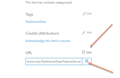

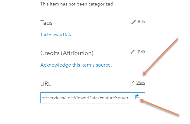

Before the "update", one could go to the item details page of a hosted feature layer, and either click on the View or copy the URL that takes you to the rest services for that item.
Now, if you click the view, rather than taking you to sampleserver#..., it takes you to your organization page with the item id, but can't navigate anywhere else.
If you copy the url and paste in a browser, it will at least take you to the REST server, BUT, will not pass any token data anymore, and will only show feature layers that are shared to the entire public.
How do I get to the REST service endpoints for services that are not share publicly, but rather to owner and/or organization?

As inconvenient and confusing as it is, apparently, this is by design.
Seems for hosted feature services, you can click on the view link, and will take you to the rest for just that service.  Then, there is an admin link you can click on that page to get to the admin features.
For hosted tile layers, you need to copy the URL (not click on the link) and paste/go in browser window.  Then, you can type "admin" in the path between /rest/services (/rest/admin/services) to get to the admin page for tile layers.
Does not appear to be a way to browse the service directory anymore, except for services shared to the public.
R_
