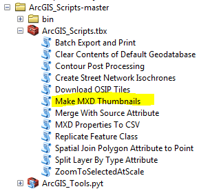

re: thumbnail creation in ArcMap...Check out   snowballsteve/ArcGIS_Scripts · GitHub   I just downloaded this yesterday myself, so have not tested, but it has a tool for creating thumbnails in ArcMap...plus looks like a few other helpful utils..
