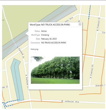

Interestingly enough, attached images do display in the pop-up in Operations Dashboard.

Hello,
How did you get the attachments to show in the pop up? I am trying to do the same but I keep getting the links
