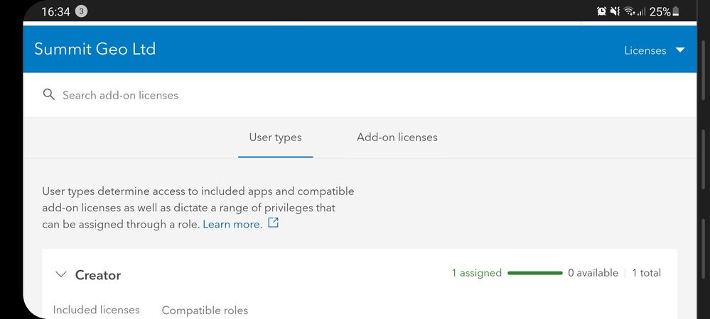

I have the GIS Professional Basic license, so I assume that includes a CREATOR license in AGOL for publishing.  Do you have any idea?
David_Brooks
MVP Regular Contributor
In the licenses menu on agol, what licence is a available to you?

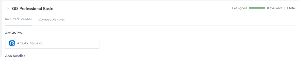

KHALEDHELMI
ARCGIS PRO BASIC License
