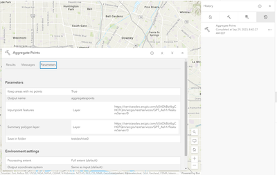

1. The only things stored in history are what you see in the history panel. This includes:
  • The parameters (including input layer URL and filters)
  • Any errors or warnings about the job
  • The time it completed, the status, and any credits consumed
  • The output layer

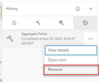

2. The history is stored within your web map. If you don't save the web map, your history is gone.
3. You can delete the history items by clicking on the X. You also don't need to save the web map, if you just want your results, and have no need for the history.
