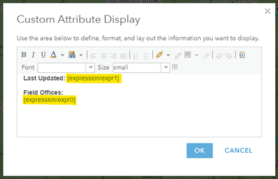

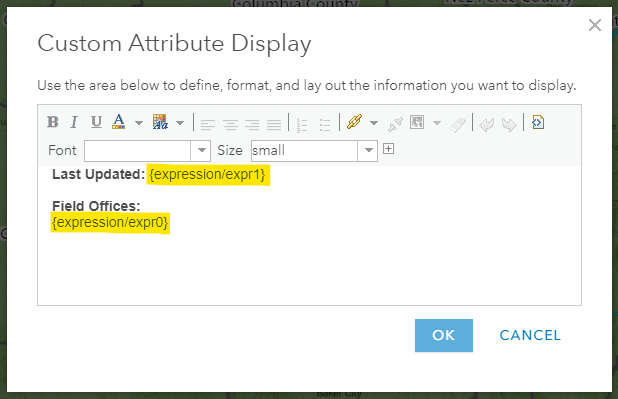

I am stuck using the Map Viewer Classic because a group I work with requires it and isn't budging. I'm trying to get an Arcade expression to produce HTML and present it in the popup, but the popup is escaping the HTML and displaying the source code. I have a layer in a webmap with a popup configured like this:
Clicking on the "CONFIGURE" button, my popup looks like this:

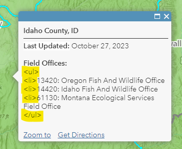

The code is producing all the values I want, but the popup is escaping the HTML tags, so it shows the HTML source, rather than rendering the bulleted list:
How do I make this popup render the HTML?
