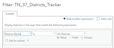

Within Map Viewer Classic I am not able to filter by field. That option is grayed out. I do have the options for Value and Unique. Has there been a change in the new map viewer that dose not support filter by field?

To enable Field option in Filter, the layer should have two or more fields of same datatype.
e.g. Field option is disabled, since the layer has only one Field (District Name) of TEXT Datatype.
But the layer has multiple fields of LONG Datatype.
