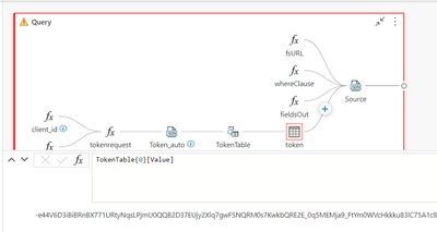

so short of it is something like this. create a new blank query and dump in below. you need to create a client ID and secret first for your account.
there's a long thread somewhere on this i'll try and dig it up

Thanks, Zoltan. finally got time to test this and it works. there are two things users need to pay attention to:
1. to use this method, the privacy setting at PowerBI has to be "ignore all";
2. From above you can image, this is not a very secure method by sharing the credential;
If anyone knows a more secure way (allowing user to login with their credential), please let me know, many thanks.
