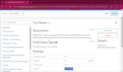

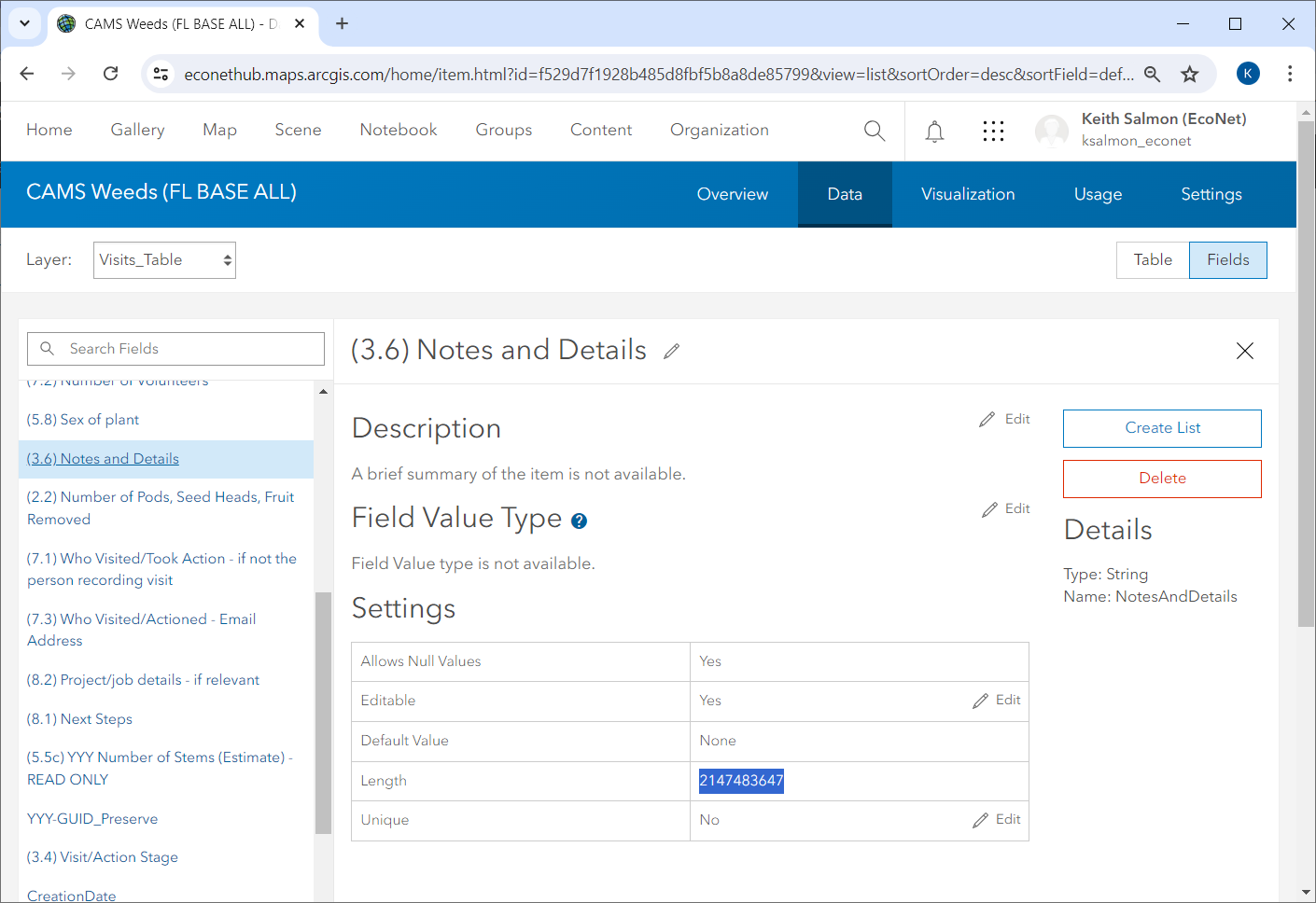

Yesterday, shortly after the quarterly upgrade, one of our automated processes failed due to a change of field length for a text field.
The field was previously 5000 long - something (not us) has changed it to a length of 2147483647.
Any feedback on what might have caused this are welcome.

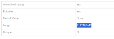

KeithSalmon
The length field is still showing as " 2147483647"
