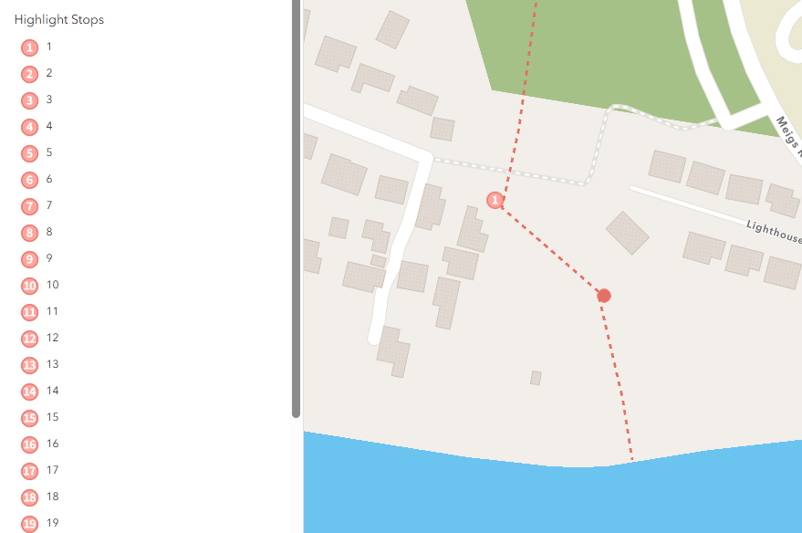

This is causing an issue because when I filter by Name in a given copy, the right features are included in the Map with the symbology configured as intended - but ALL features from the original Web Map still display in the Legend. E.g., for Name = Group 3, there is a single feature with symbology from Number, but the Legend still shows features for Numbers 1-19.

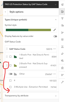

In the Map Viewer configuration, could you simply go to the symbology options for the layer and drag the values you don't want to display below into the group that is hidden from legend?
See screenshot, using a layer from the Living Atlas:
