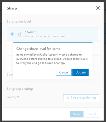

I had to remake a map with shape file imports because my local ArcServer is down.  It contains some sensitive info from some other agencies. I reassured them that I could make the map only visible to our group, not the public, like last year. So why am I getting this message when I try to adjust the maps sharing? : "Items owned by a Public Account must be shared to everyone before sharing to a group. "  I have other maps in my account that are not shared with everyone. Did my account type get modified since the last time I saved these maps?

AbeCoughlin
FYI - I've just received the same message within a new install of ArcGIS Enterprise 10.9.1.
I had just published a simple enterprise database dataset via ArcGIS Pro 2.9.9.
  • I had published both a map and feature layer referencing the database dataset.
  • I had shared it to a specific group only.
On viewing the items in Portal I noticed they hadn't been shared, so I selected both and went to share it, and that is when I received the message.
A key oddity with this is that it is ArcGIS Enterprise, not AGO, thus 'public' vs 'subscription' accounts don't appear to be relevant.

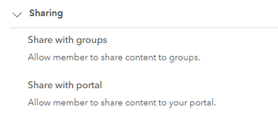

Exploration of the issue:
  • My user belonged to the group I was sharing to, but just as a Member.
    • When I set my user to be a group Manager and retried, I had the same problem.
  • My user is a modified 'Administrator' role, without xxxx.
    • When I set my user to be the full 'Administrator' role OR the 'Publisher' role OR a modified 'Publisher' role and retried, I had success
  • Reviewing the permissions for the modified 'Administrator' role, I saw in the Sharing section that I had not allowed 'Share with Portal' - allowing this and retrying resulted in success.
    • Note that I had not allowed 'Share with portal' as I had already allowed the 'Share with groups', the option above it - I believed that the permission to share with groups would allow me to share with the portal (surely one cannot happen without the other?).
Summary Statements
  • It appears some remnants/components of AGO exist within the Enterprise implementation (in this the oddly worded warning message above).
  • Permissions for roles are not inclusive, i.e. checking one permission does not necessarily include the other permission even if logically it should (yes, my logic!).
  • Recommendation - change the order of the permissions - put 'Share with portal' above 'Share with groups', and possibly link 'Share with groups' with 'Share with portal' - I cannot think of a reason why you could share with a group but not the Portal.
