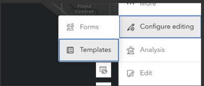

Just following up in this thread to let you all know that support for managing templates has been added to Map Viewer as of the Feb 2025 update to ArcGIS Online. You can check out this article to learn more. Happy mapping! https://www.esri.com/arcgis-blog/products/arcgis-online/data-management/optimize-editing-with-templa...

EmilyGeo
This is available at 11.5. To edit a layer's feature templates, you must be the owner of the layer or an administrator. The layer must also be a hosted feature layer.
