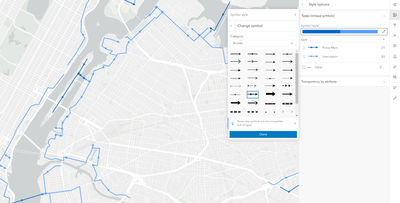

RussRoberts
Esri Notable Contributor
Use Map Viewer instead of Map Viewer Classic and you can use a similar symbol set. You can also publish your own web style from Pro and use that in Map Viewer too.

Hi Russell,
Thanks so much for the tip on switching to Map Viewer rather than Map Viewer Classic. I did this and used the left side bar to select layer I want to work on and then looked at the right side bar (as you show in your screenshot) but I seem to have limited options (screenshot 1). If I then click back on the layer I want to edit I can see the toolbar on the right changes with more options but they all seem greyed out (screenshot 2).
Do I need to be on some different membership for access to these tools?
Sadly, I don't have access to Pro right now so I don't have that option!
Any further thoughts appreciated! I'm relatively new to online ArcGIS and it looks to me like the Map Viewer Classic is older and Map Viewer is the newer version- is this correct?
Many thanks again
Katy
RussRoberts
Can you share the map with me but from what I can see is the layer type being used is probably a feature collection which has minimal support like styling. How did you create this layer ?

RussRoberts
The issue is the imported file shapefile is not fully supported for authoring this type of feature collection so the layer authoring is limited at this time. Publishing to a hosted feature layer will expose the full layer authoring for an example layer.
