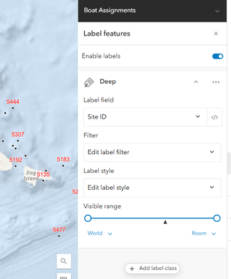

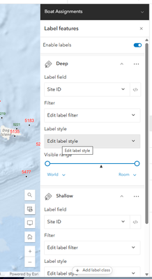

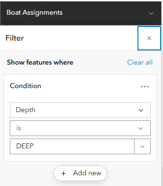

Unfortunately you can't assign colors to a label using Arcade. Instead, you'll have to create label classes for each symbol. In this first class, I want to show the deep points with a red label
Use the Filter to show only that attribute and set the Label style.

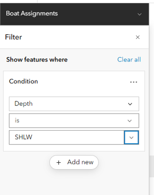

Here I've added another label class to show shallow points with a smaller green label.
This class uses a different filter

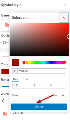

What you can do, is go to the symbology of the item you're wanting to match like this here:
Click the Color and hit done:

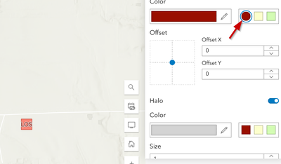

This will add the color to the selection wheel (I already clicked done on mine previously):
Go to the label, edit the label style, and choose the color from the wheel you had chosen before:
You can adjust the Halo, and background the same way.
