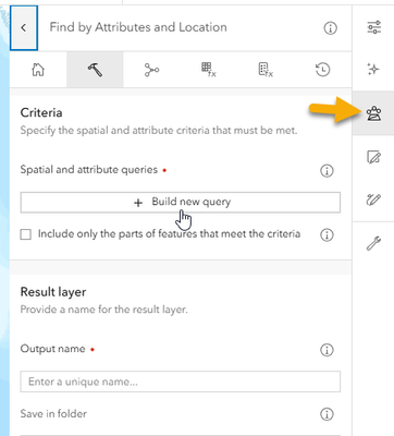

If so, this is super easy to accomplish using the Find by Attributes and Location tool.
1. Add your stores and interstate datasets to a map
2. Navigate to Analysis > Tools > Find Locations > Find by Attributes and Location

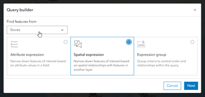

3. Click on the + Build new query button
4. Choose to find features from the stores layer, and then pick Spatial expression
5. Set the query to find features within a distance of 3 miles of your interstate layer
6. Click Add, then provide an output name for the result and click Run.
Note: if you only want to analyze the stores that are currently displayed on the map, you can set that by expanding the Environment settings section at the bottom of the tool and changing the processing extent to Display extent before clicking Run.
7. Once the tool completes, you will get a new feature layer containing only the stores that are within 3 miles of a highway.
